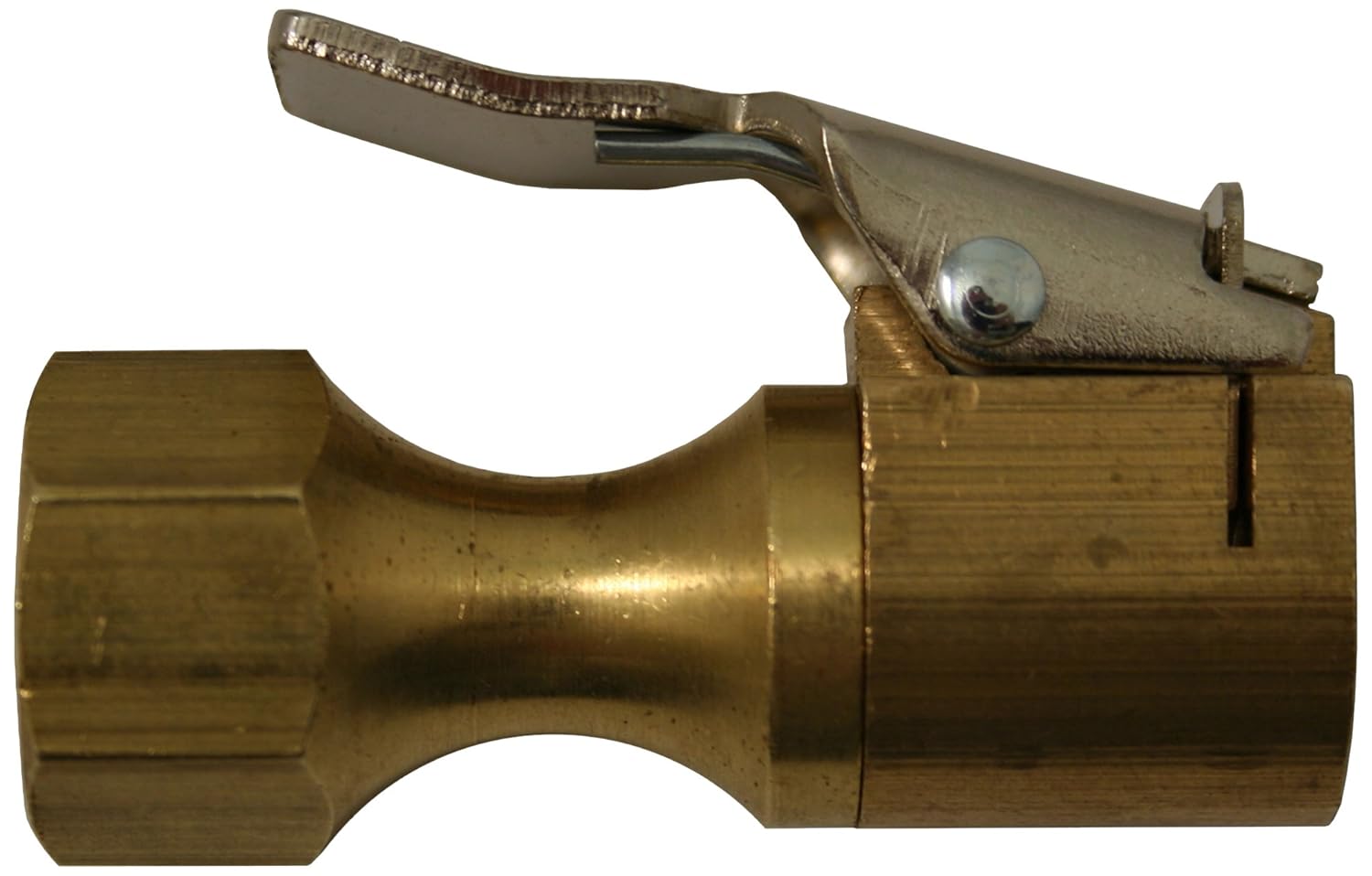

    On chucks and inflator gauges/guns, I initially bought a Viair one and they are cheap junk (in sharp contrast to their compressors). What I found in doing my research is that MOST tire gauge/inflator guns have a low CFM (around 1 psi) and low gauge accuracy. Unless you spend a lot of $$, it's not possible to find a good one. Why have a compressor capable of 2.30 cfm (or more) if the inflator/gauge is only good for 1 psi? Many of them don't even provide specs. For now I'm using an ordinary ball chuck. If you read online reviews, many of the lock-on style chucks that come with inflator guns don't work well and need to be replaced. I bought a lock-on chuck like in 3rd photo that I may switch to. If using a lock-on tire chuck, you must use either a tire inflator gun ("stick" or pistol grip style) or a regulator otherwise will risk over-inflating a tire.
