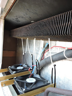

Mid day as the sun reached that side of the rig with 87F ambient air temp the fins were about 110F This evening at 6:30, the fins are at 99F Problem: Food temp has risen to around 45F
Yesterday, before replacing the lower vent cover the food temp was 38F
I have not yet put the top vent cover back in place.
This is the best side view I can get to the fans and the fins at the upper vent. Do I need a baffle from in front Outside edge) of the fans to the bottom corner of the condensor fins?
