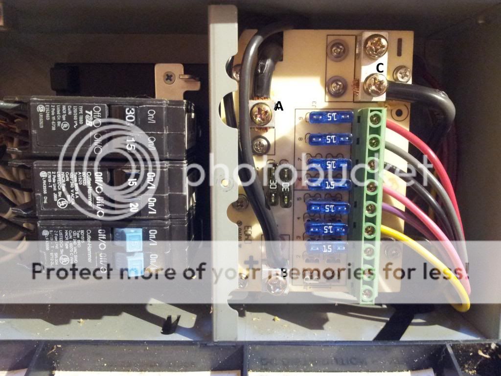

This is almost too embarrassing to post, but I need help in hopes of salvaging our weekend trip. I replaced the trailer-side 7-pin connector on my TT today without disconnecting from shore power, unplugging or turning anything off or otherwise taking any precautions. Long story short - in the process of that I shorted the 7 wires together as I was feeding them through a rubber boot on the new connector.
Now, none of the 12V items or outlets in the trailer work. Also, the A/C does not come on (the breaker is in the on position). The breaker to the microwave was turned off at the time I shorted the connector wires, and when I flip it to the on position, the microwave works. The 110 outlets in the trailer are live.
At the electrical panel, on the 12V side, none of the fuses are blown, including the two large ones. None of the 110 breakers are tripped. None of the three fuses on the PD9180 charger are blown. The large fuse in the cable between my battery bank and the PD9180 is not blown. (Oddly, after I pulled and replaced the fuses in the charger, the pendant began blinking rapidly, even though it has been plugged in and charging for a couple of weeks - I don't know if that is relevant to diagnosing the problem or not.)
I'll be very grateful to hear any suggestions on what I should check. I have a multimeter. Thanks in advance.
