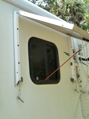

    There is the member that has two panels mounted not only vertical but tillable and portable too.
    That most likely would be me.
    I think this is a pretty smart way to go. I really like the window awning application! And, you don't have to get on the roof to clean the panels.
    The panels can be propped up at an angle or easily removed.
    If I'm parked in the sun I can leave them attached.
    If I'm in the shade I can lift them off and set them in the sun.
    Hey, I tilt :C (just figured out that 58 degrees is more vertical than horizontal, too).

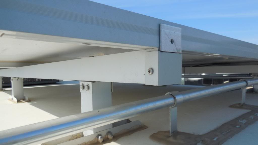

  • westend wrote:
    I think it was Mena that went on his roof and made shade patterns for all of his rooftop accessories. You could search for his thread about how he overcame rooftop obstacles. As CA Traveller, said, when you start getting the modules up off the roof surface, you'll gain a lot of module real estate.
    This thread here: Solar Panel Placement on Roof
  • Hi,
    I am considering replacing my awning with vertically mounted panels. I would include tilt.
    In winter time vertical installs can get a greater harvest because of light "bouncing" off the snow.
  • These panels using 2" used aluminum screen porch material could have been mounted higher.
  • 90" will fit three 24V modules with an overhang of 15" total. I wouldn't do it.
    Since there are so many mounting choices and module sizes available, it really doesn't make too much sense to mount them on the sides of an RV. Only those with definite lack of roof real estate and needing large amounts of power need apply. To me, the downside of mounting on the sides (besides the inefficiency) is the possible damage from road debris.

    Every square foot on your rigs roof top with the exception of high antennas is available for solar panels. Many only consider mounting them 2" off the roof - start thinking higher even right over the ACs.
