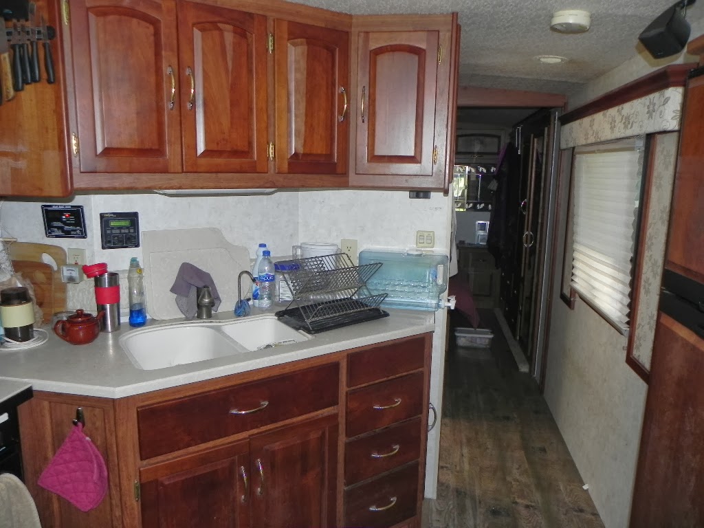

The BlueSky Solar Controller is the black panel with the red light on, to the left. The Xantrex remote is next to it.
The vent stack is in the wall behind the controller. The battery and electric compartments are located roughly below the white plastic box on the floor in the bedroom (right).
The output from the controller continues down the wall then forward a few feet to under the drawer below the fridge.

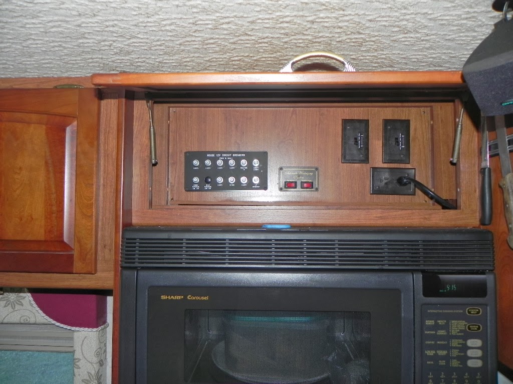

12V breakers above microwave/convection oven

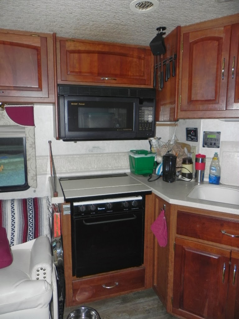

Under the drawer below the stove.

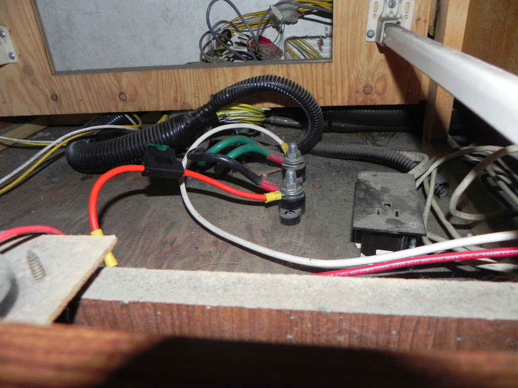

Connection to bolt terminals from battery, location of original converter. Cables also go up to 12V breakers from this point. Not to point out the obvious, but the white and red wires and 30A fuse are from the controller output.

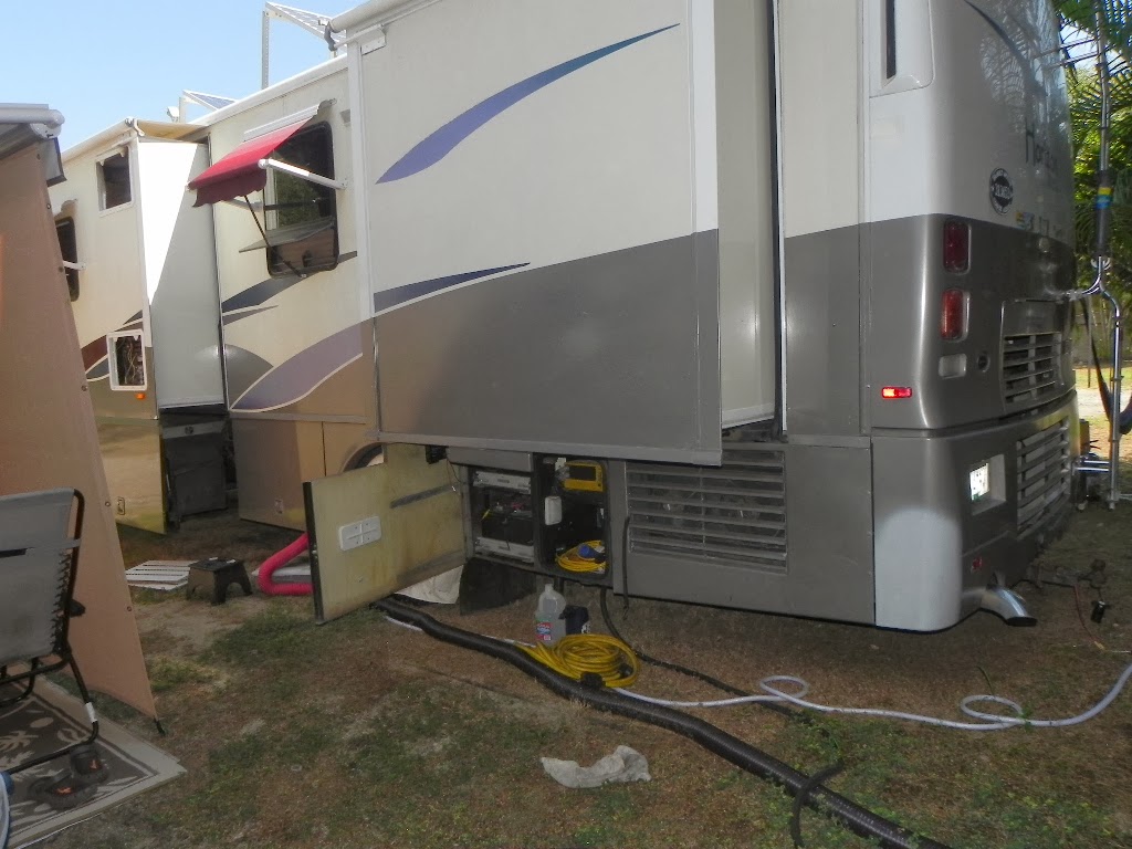

These are the battery and electrical compartments. The stuff on the ground belongs in there too, except for the large white bottle of distilled water. I'm not sure where we can mount the controller.
