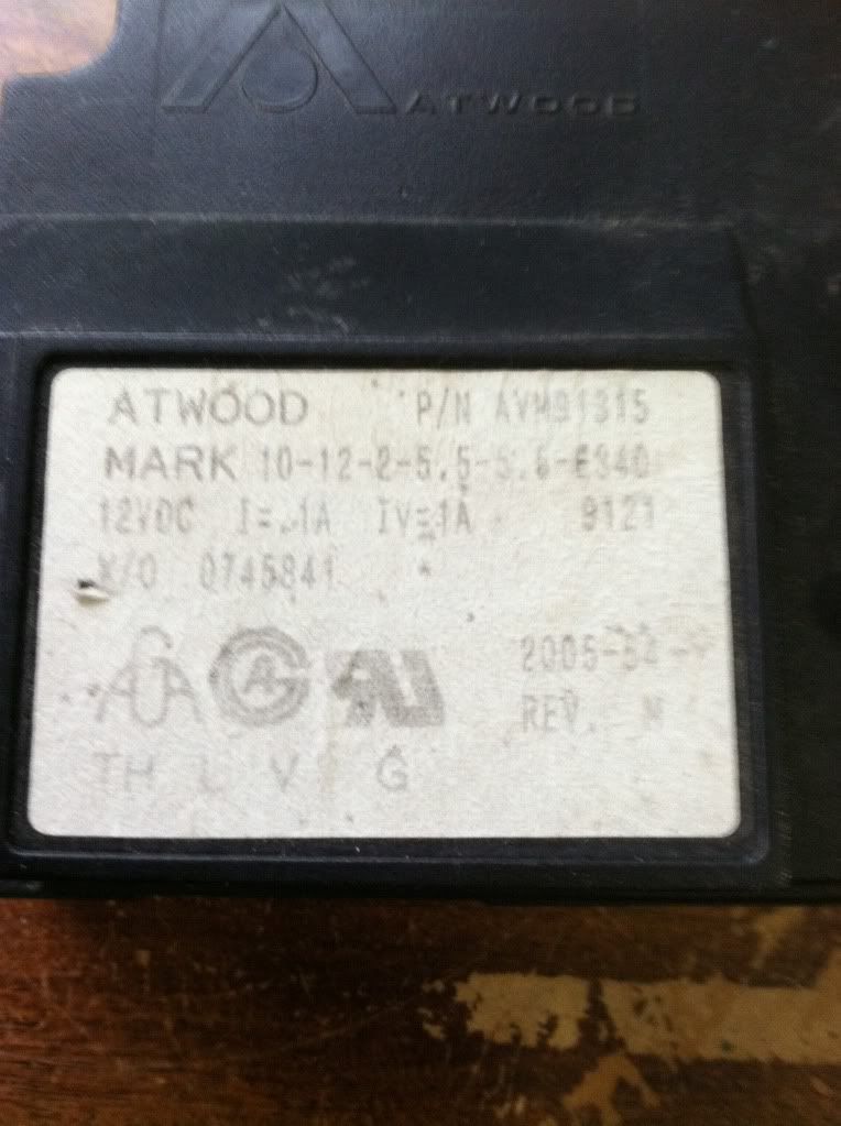

Hello all,
The last time I was out, I had issue with the water heater. I had the control module tested at a local RV shop and it worked fine for him every time. You could hear when the igniter would kick off. I installed it back into the heater and it worked the rest of the week.
Im planning another trip next week and started my pre-trip checks and the heater is acting up again..same as before.
I suspect this control module again.. My question, is this the most likely part to fail?
I have attached a couple of pictures of it.. I have shopped around on line a little and have found some from $120 to $150. If this is the part suspected to fail, I don't mind getting a replacement.
Here is the specs on the heater. Its an Atwood model GH6-6E, module part number is AVM-91315. This part is original and the RV is a 1992 Winne.
Thanks for your input!!

  • Unfortunately I do not have the manual for this unit.. When I this box out on my desk, I noticed bug parts falling out of it. I kept tapping it on the desk and at least 6 dead lady bugs fell out if it. There are open hole where they can get into it.
    I reinstalled the unit and it fired up every time. It fired up 10 times in a row yesterday.. I tried it again this morning, it did not lite the first time, but did every time after.
    When it does not lite, you don't hear anything. When it does, you hear 4-6 spark attempts then it fires right up.
    I do not suspect the gas valve at this point. When its lit, it is burning fine. Good flame and all.
    This unit was built in 1992. What is the likelihood this box is on its way out? I have found replacement modules online for $120. In my local RV stores they are around $200.
