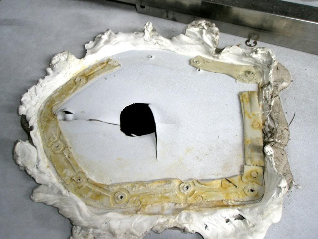

  • I found a number of problems with my antenna installation. One that was not obvious was the failure of the caulking to adhere to the metal antenna base. It appeared to be just fine, but only after removing the antenna was the problem discovered.
    See my album for more information:
    Album
