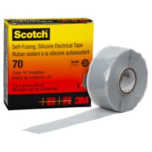

  • Use a Kearney Split Bolt
    A hardware store item. From tiny to huge.
    Tighten the snotteroo out of it then use self fuzing electrical wrap.
    and presto! It will be done right...
