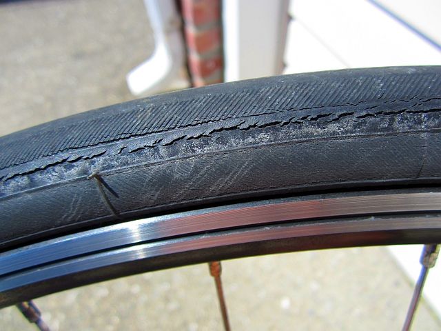

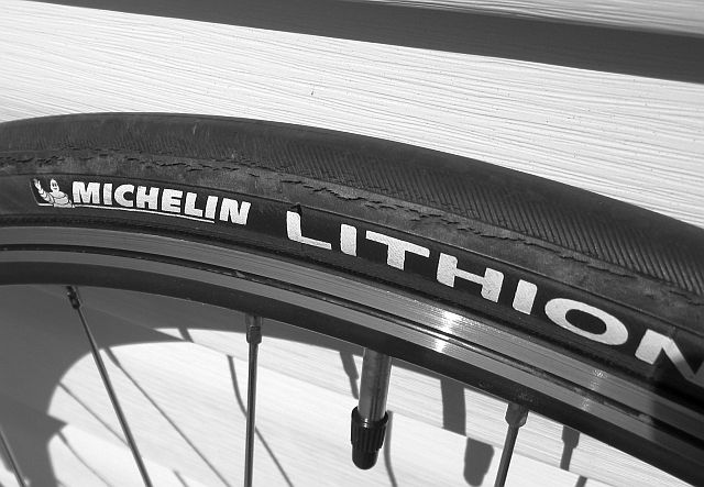

As for the last tire image...it from my road bicycle after getting doored...that
destroyed my fork/tire and messed up my chest. +$800 bucks worth to my 30 year old
road bike.
My speedo says just under 60 MPH when going down some local hills...think a bit
less, but after checking out my crumpled bike waiting for the cops...noticed that
the tires (front and rear) were cracked. So took pictures for these types of
discussions.
Association is that they are the same OEM and same experience with bicycle and
auto tires. They were about 1 year old...NEVER left outside over nite,
always garaged on a rack with no load on them over nite, 303 on all of
my tires (one of those Michelin area reps said warranty denied if they
found anything other than 303 was used). Sidewall says max PSI of
around 119 PSI and aired them up to 110 PSI

I now have Conti Gater's on that Trek 1000 road bike and Bontrager's on my
Trek Madone 6.5
The Conti Gaters are stored on the same bike rack, in the same garage
and ridden on the same roads (albeit less miles now that I have a
2nd road bike) and they show ZERO cracking and actually perform much
better than the Michelin 23mm X 700mm's
