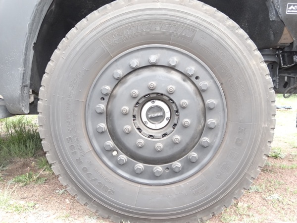

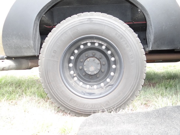

One drawback I have heard is stiffer ride when empty, which is fine because I seldom drive my truck unless it's doing something a truck has to do. Otherwise I have a couple other vehicles I drive. - msiminoffExplorer IIThe only Fords I have seen with 22.5" wheels are from EarthRoamer.. They require an adaptor and body modifications and/or lift in order to avoid rubbing.
If you currently have a dually and want to run SRW then I suggest you take a look at the 19.5" wheels from Hutchinson. Note: these are 10-bolt wheels and will require an adaptor.
