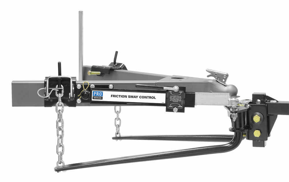

    There are many types of anti-sway systems, I'd look into a friction bar type. They are about $100 or less.
    Here is one installed, the other bars you see are the WD system.
