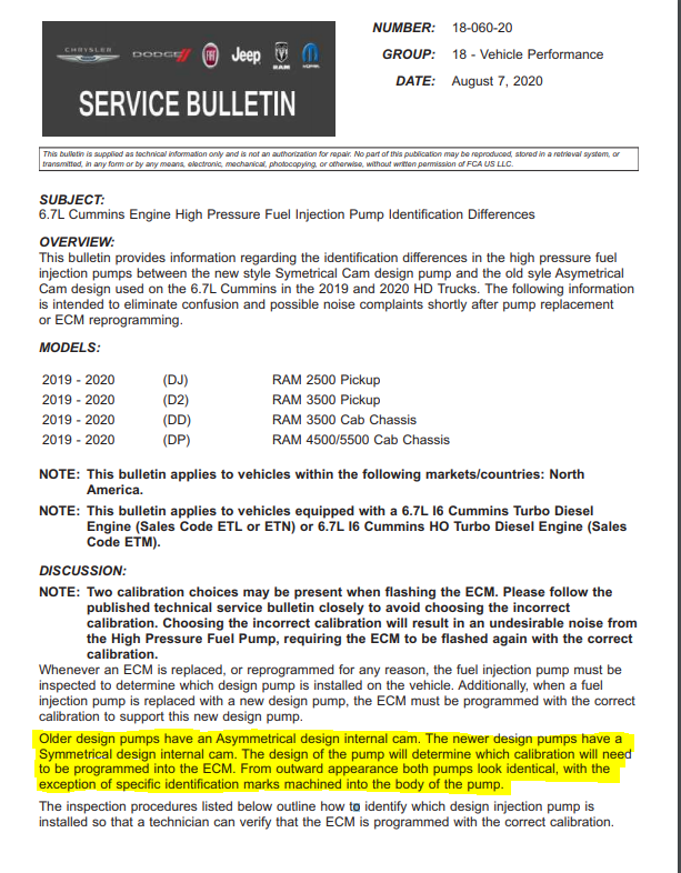

According to FCA, they did not change the pump from a CP4 to a CP3. They did, however, change the from an asymmetrical to a symmetrical cam design. A CP3 would not look identical to a CP4.
FCA TSB 18-060-20

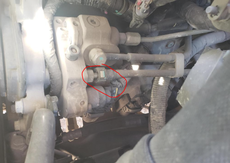

TFL says 400 horsepower, Drivingline says 420 and Ram says 430. They all say 1075 lbft of torque but no one says at what rpm max torque is produced. Then on the Ford side some Ford publications say peak HP is obtained at 2600 rpm whereas other Ford publications say 2800. the same goes for peak torque ... is it 1600 or 1800? If these numbers are so important you'd think they would get there ducks in a row before publishing them. They used to publish torque curves. At least if they gave us rpm along with peak torque and power values we could speculate what the torque curve looks like. - Cummins12V98Explorer IIIShiner, this is a pic off the TDR that the guy took today off a 2500 2021 model. What say you now?

- ShinerBockExplorerAccording to FCA, they did not change the pump from a CP4 to a CP3. They did, however, change the from an asymmetrical to a symmetrical cam design. A CP3 would not look identical to a CP4.
FCA TSB 18-060-20

This is the type of fitting the factory would use.

- ShinerBockExplorerThis is the type of fitting the factory would use.

Fake news. That is an aftermarket CP3 installed to make it look like it was factory. The line with all the paint would not be that type of fitting. The factory uses quick disconnect safety lock style fittings, not a flair style fittings. Although I will give them extra credit for the quality control style paint on the fitting.
Man, people just believe anything they see on the internet these days without verifying it first.
Just like that and hope is gone.
Sorry, but there is no way a factory would use that type of fitting. It would cost them lots of time and money to have someone keep spinning a wrench to install that line on every truck versus a quick disconnect fitting that takes a second or two to install. - 4x4ordExplorer III
