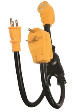

Yeah, I was referring to these:
Since most 20amp/30amp/50amp pedestals have a GFCI 20 amp outlet, and that adapter is GUARANTEED to trip the GFCI circuit, not only is that adapter expensive, it is also nearly worthless. It is guaranteed to trip the GFCI circuit because the same neutral wire is used for both the 20 amp outlet and the 30 amp outlet, Since the 30 amp outlet is using that neutral wire, the current on the neutral wire of the 20 amp GFCI outlet will not match the current on the 20 amp GFCI hot wire.
Sorry that I confused which adapter you were referencing earlier.
If it's a modern to-code 50A pedestal then just use the 50A =)
I figure that's more designed for older parks with no 50A available and a user that wants to run a pair of ACs, would easily work if the second AC is a 13.5.
As long as the 20 amp outlet is NOT a GFCI outlet, which was the whole point.
