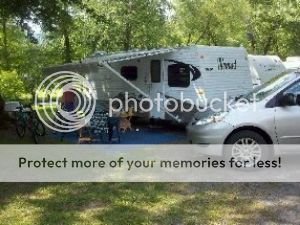

  • Here's one like we used to have. It weighs around 2700 lbs dry. It's a Skyline Nomad 186. It has a bunkhouse that you can use for great storage if you don't have kids with you. We towed it with a Toyota Sienna (3500 lb limit). No problem. Click the link below:
    CLICK HERE
    And here's a picture of us camping in it and the minivan we towed it with.
