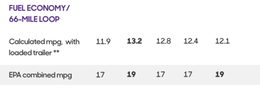

When Pickuptucks.com tested the Ecoboost versus the GM 6.2L, 5.7L Hemi, and Nissan 5.6L back in 2018, the Ecoboost got the best towing mileage and unloaded mileage. However, the 6.2L did get better fuel economy than the other two 5.xL engines when towing. I have read multiple reviews ad MPG loops the 6.2L even got better fuel economy than the smaller 5.3L when towing as well. I am not sure if it is the premium fuel requirement, but many tests I have seen showed the 3.5L Ecoboost and GM 6.2L neck and neck with each other on fuel economy when towing and both are generally better than the rest of the engines.
2018 Best Half-Ton Truck Challenge
I guess I didn’t dig deep enough in the article, but under test results, they call out the EcoBoost for its poor towing MPG.
And, off subject, but I believe at this point both the 6.2 and 3.5 have the same RECOMMENDATION for premium fuel for best performance (not requirement).
Anyway, if the 3.5 is at best equivalent to engines twice its size in towing MPG (I’m still sticking with its worse) than what would a EcoBoost 7.3 be equivalent to? Sounds like it would be the equivalent of a 16 liter engine which MPG would be unimaginably bad.
Regardless if they call it out for unexpected lower fuel economy, it still got better fuel economy towing than the rest.
However, you will use more fuel economy than the others if you are using more air to make power. If your old 6.2L was not able to keep speed while your Ecoboost is, then you are likely moving more air in the Ecoboost than you were in the 6.2L meaning you are using more performance than the 6.2L was capable of and therefore using more fuel. If you are utilizing more power from engine A versus engine B, then it is kind of a no-brainer that you will get worse fuel economy in engine A.
Also, there is a huge difference in the premium recommendation between the two. The 6.2L is tuned for premium and its advertised power numbers are based on premium fuel which it clearly states on its SAE certification. If you put regular fuel in it, then you get less power than advertised and have a higher chance of knock due to its much higher compression ratio.
The Ecoboost on the other hand is tuned for regular fuel, but can adjust timing to take advantage of premium fuel to make more than advertised power. For example, my old F150 Ecoboost made 365 hp on regular and 385 hp on premium according to Ford. It doesn't need it, but it is recommended if you want more power out of your engine which is generally when you are towing.
