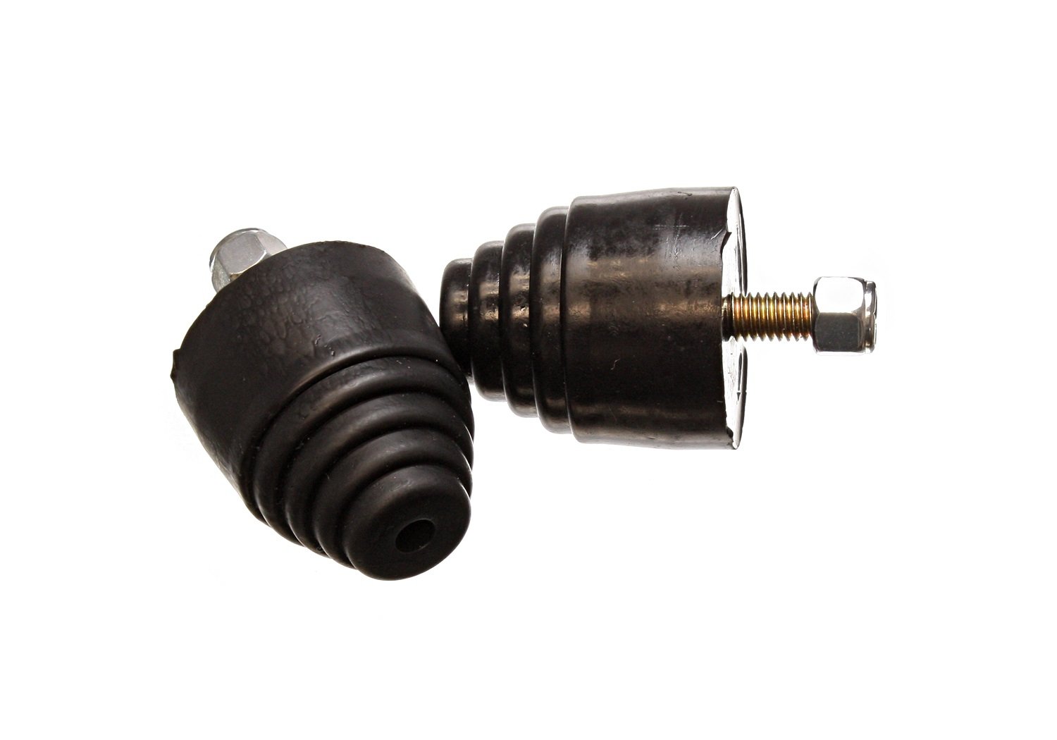

You can just have someone weld a short block of rectangular tubing to the frame to stop the spring's bolt plate from moving too far up. That's what I did. Most likely you'll never hit it anyway.
There are various bolt on rubber bump stops out there, not necessarily for RVs.
Like these:
https://www.amazon.com/Energy-Suspension-9-9101G-Purpose-Bump/dp/B000CNB5OK
Probably 99.99% of the people don't have anything and never have a problem. So who knows. - Camper_GExplorerI didn't read all the replies, but in short, no regrets at all. My Layton was low also and drug the rear bumper going into my driveway. No issues after the relocation. I love it this way. Good luck
