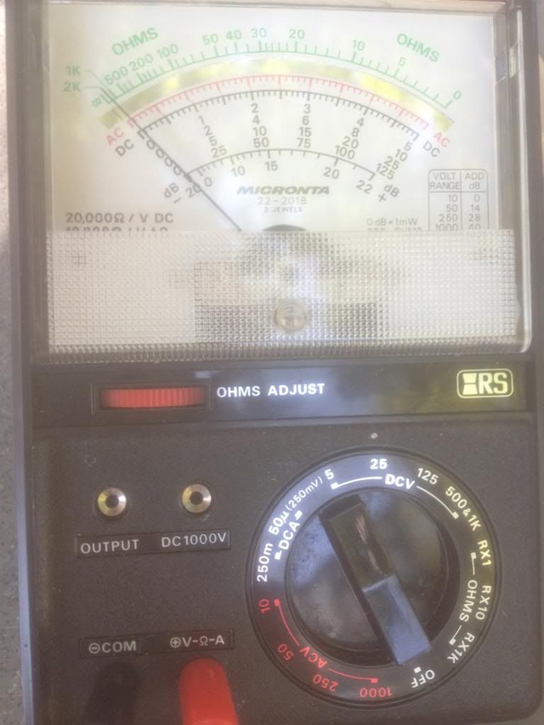

  • rcosta wrote:
    Photo of my multi meter
    Thanks for the help with the mulit meter. I get what you are saying for the most part. If you could though take a look at the meter I have. There are 4 places to put the wires. Have I chosen the correct 2? Also, there does not seem to be a place for 20 amps, so I put it at 25.
    This is an old meter, so maybe it is obsolete.
    Thanks again.
    Like I said you need to find an electrical person who can show you how to use a meter and how to test for things. There are many around.
    Don't be fooling around with that meter if you don't know what you are doing. You might get hurt or burn up your meter.
    Jerry
  • Yes, your meter is set up properly, but you really should use a digital meter. A digital meter will show you the slight difference between 12.3V and 12.6 volts.

  • Photo of my multi meter
    Thanks again.
