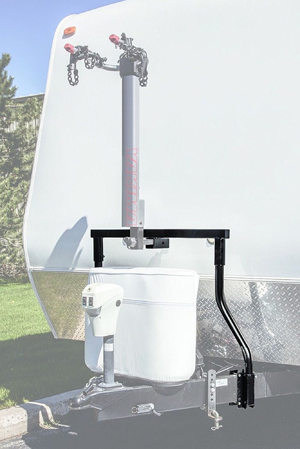

You CAN buy a specially designed rack that goes on your trailer tongue, looks better and no need to add extra potential water leaks to your trailer (these things leak easily enough without adding extra points to leak).
If you don't want to spend the money on a A frame bike rack, there are adapters you can buy that mount to the tongue A frame that allows you to use a standard hitch bike rack on the trailer tongue.
Stromberg Carlson..
Neither option is cheap but, both options are the better way to go than trying to dangle junk off the back of your trailer, best of all, the bikes ARE in full view of your rearview mirror, no more guessing if you still have the bikes or if they decided to take a scenic ride without you.
