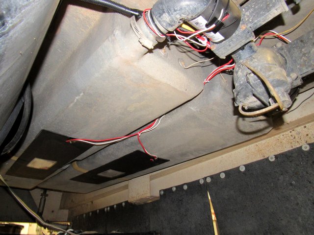

I bought these 12v tank heater pads and two heat pads to go next to the drain valves.

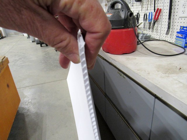

I bought a 4x8' sheet of, look like plastic cardboard and a roll of
Reflectix that I will cover and help insulate the tanks.
I got the pads installed and got them wired enough that if I need them I can just plug them in.
I still need to make the cover and wire the heating pads to a switch.
They have built in temperature sensor to turn them on and off.

  • Lwiddis wrote:
    Well thought out. What’s a pad’s amp draw?
    Thank you. :)
    5.8A / 78w per pad.
