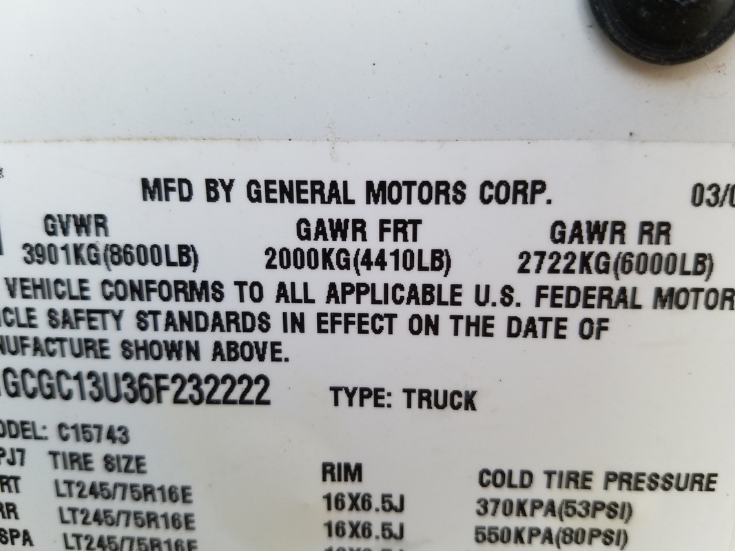

Question: What was the difference between a Chevy Silverado 1500HD and a 2500? Both have heavy axles and the larger V8.
Lower GVWR on the 1500HD. Echoing what DRSteve posted, It was 8600 GVWR.

If I remember correctly, the 2500HD came out in 2001. Prior to that the 2500 was a non HD designation, and could have been 8600 GVWR.- JIMNLINExplorer IIIThe door tag posted says it all about the '00-'06 1500 HD 6.0 engine 4L80 tranny . Mention the 1500 HD and some uninformed members say it can't pull anything but a small TT or popup.

Now we have a 40ft fifth wheel, and a 3500HD dually. - blt2skiModeratorThanks for pictures drsteve. Was thinking the base weight was around 5500-5700 lbs, leaving one with about 3000 lbs of payload!

Marty - drsteveExplorerDoor stickers from my 2006 1500HD. Crew cab, LT trim.
