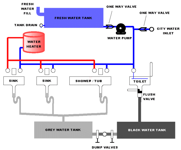

Hello,
I recently bought a used 2014 Keystone Bullet travel trailer. The generic owner's manual does not specify whether or not the switch over to city (pressurized) water is automatic when there is pressure present in the city water connection, or if there is something that has to be done in order to use city water. In speaking to a rep at Keystone, I was told that the internal water pump would have to be turned off, and then the pressurized city water would be used. Is simply turning the water pump switch OFF the only thing I need to do? Also, if the pump is switched ON while city water is available, which water source will be used? Thank you for any help that is provided.

  • Like most I switch off the pump when hooked to campground water. I do carry fresh water and have use it a time or two when the CG water was kind of funky.
    As the diagram shows we have check valves to prevent cross feed, so if the pump was on, it would pump if the CG pressure was low.

  • Typical RV Trailer water system.
    City water connection feds cold water system directly and ties into same cold water line water pump feeds.
    Off of the cold water system is a inlet to water heater which then feds hot water system
    City water connection has a check valve in it to prevent backflow out connection when using pump.
    Pump has an internal check valve to prevent backflow thur pump when using city water.
    When connected to city water pump can be ON but wouldn't run due to pumps pressure set point for starting.
    IF city water pressure should drop below pump start set point pump would run and supply system until city water pressure recovered. Provided you have water in fresh water tank
