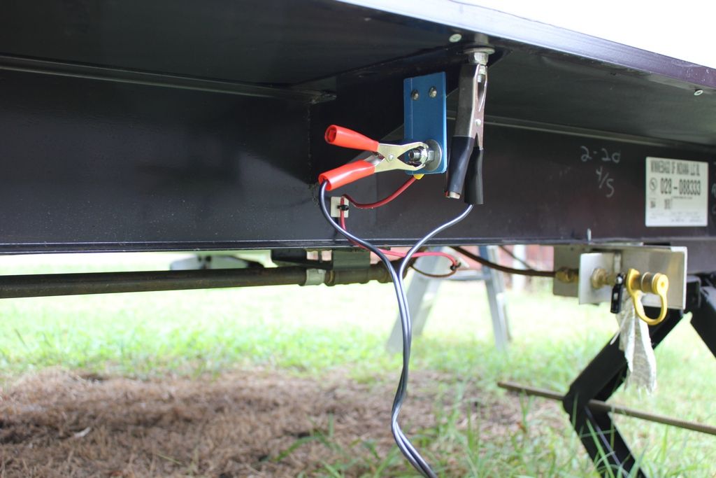

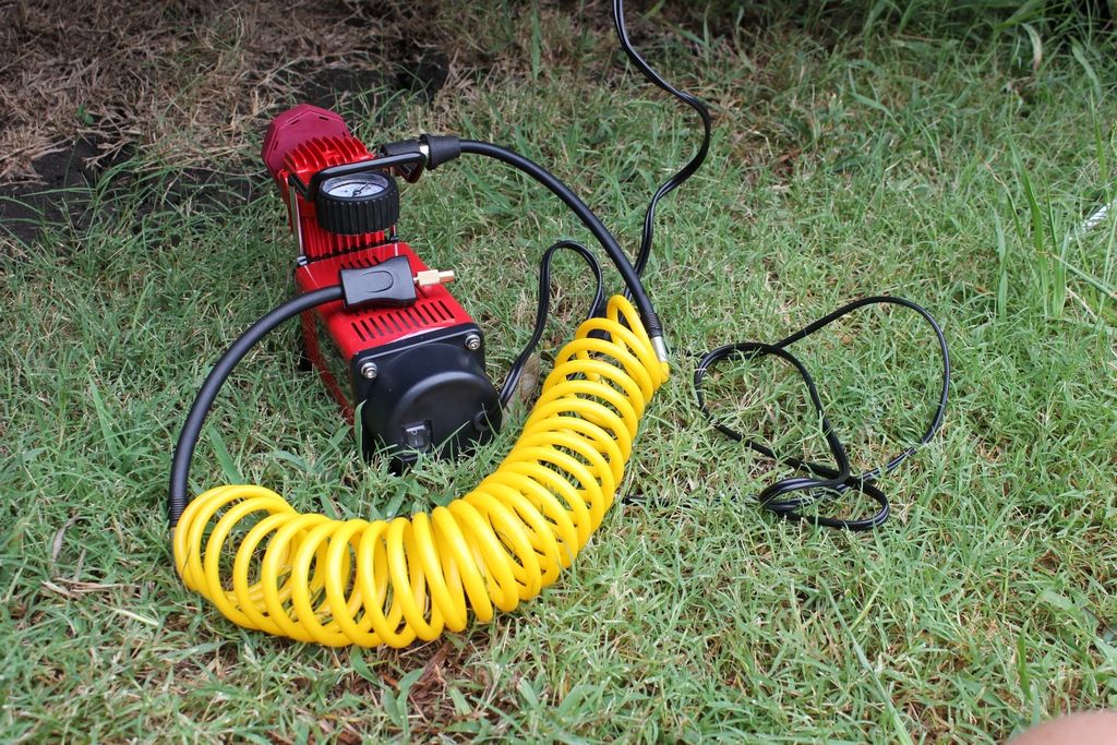

If I were you I would not move the trailer until the pressures are aired up to 50 psi. As others have suggested, you can get a 12V air pump (you should have one anyway if you are RVing) and do this before you leave. One of the mods that I will be doing soon is to add a 12V socket outide the RV so that I can easily reach each tire with my air pump.
