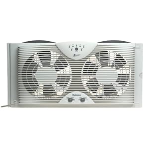

As westend said, you need a fan to circulate the warm air.
Opening the doors would rely on thermocycling--and that only works if there is a large temperature difference. 5 C is not a large difference.
I replace the return air grill for the furnace with dual window fans. Happily for me, that pressurized the heat ducts and keeps the cabinets warm.
dual fan
dual fan
