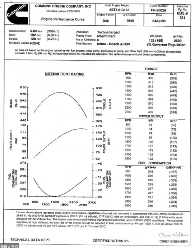

4x4ord wrote:
This is very useful info but it needs to be interpreted properly. So the 5.9 was capable of achieving its best fuel economy at 2000 rpm BUT that is under heavy load. Under heavy load it was able to make 175 hp at 2000 rpm. If its fuel consumption was measured at 2000 rpm and it was only loaded to 50% of its capability it certainly would have been using more fuel than .334 lbs per hphr. I'm talking about slowing an engine down under light load conditions to improve fuel economy.
If that old Cummins had a demand on it of 80 hp, I would call that a light load, It could easily produce 80 hp at 1500 rpm and I would be willing to bet it would achieve better fuel economy producing 80 hp while running at 1500 rpm than it would running 2000 rpm with a 80 hp demand on it.
The new Powerstroke is a totally different animal. At 1600 rpm it can produce 320 HP.... 380 hp at 2000 rpm. I am saying 175 hp demand on a new Powerstroke engine qualifies as a very light load. It doesn't need anywhere near 2000 rpm to produce 175 HP. In other words 175 HP to the new Powerstroke is like 80 HP was to the old 5.9 Cummins.
And I think it is very few RVs that even require 175 HP to pull them down the highway at 70 mph. So I'll stick with my claim that 4.30 gears are not the right gears for RVers wanting a new Powerstroke. If you want a F450 for the wide front axle it is understandable but the 4.30 axle unfortunately comes with it.
According to your numbers, the 175 hp needed is 55% of max available power at 1,600 rpm and 46% of max available power at 2,000 rpm.
I would not call that a very light load or even a light load in terms of what you are demanding from the engine at those rpms. To me, below 15% of max capability at X rpm is a very light load.
I think you are looking at this in terms of max potential of the engine itself instead of max potential at a certain rpm. That is not how it works. At wide open throttle(full load) at 1,600 rpm, all the PSD can make according to your numbers is 320 hp. Half load at that rpm would be 160 hp. It does not do its max of 475 hp at that rpm so you have to look at it terms of how much of a load it is at that rpm, not at peak hp numbers of the engine.
