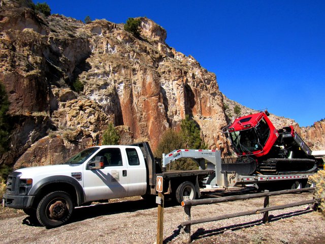

:):) - carringbExplorerSounds about right. Actually 9.5 MPG empty is on the better side. The low solo MPGs is from always being in regen. The low loaded weight is because it runs at a relatively low combustion temp, in order to meet NOx emissions limits without SCR, but that ruins efficiency.
Also, if the snow cat is a typical load, that's part of too. Having the frontal area of the cat so far back, adds way more drag than if the same frontal area were closer to the cab. - spectaExplorer

I went and picked it up today, its a "seasonal" truck. They use it up north to tow a trailcat (small 8000 lb dozer) and bring snowcats in for service.
I went 200 miles on the freeway today without one regen. :B
It used to do it in the middle of climbing steep grades towing the snowcat and drop all the way down to 28 mph. I hated that.
It would drop down to 45 mph on the freeway when it went thru the regen. Is that normal? I hope they fixed that, what a pain.
The did several thousands of dollars in repair in the spring, new regen pump, catalytic converter, 3 sensors and intake gaskets.
The people up north said it ran great all summer. I'm hoping the same thru the winter. - spectaExplorer
