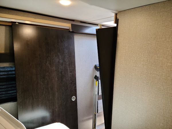

At the front of the coach, I chose to re-use a path from roof to basement that I'd used for the solar panel wiring. I'd routed that into the coach thru the bathroom roof vent and down an interior wall. To be able to remove the wall panel itself, I had to also take down the sliding door to the bedroom, which is ideally a two person job but can be done by one if you have a way to support the bottom of the door while removing the lag screws that attach the slide channel to the ceiling. Once that was fully removed, it was simply a matter of pulling the panel forward from the non-hallway edge. As the hallway edge is finished with a piece of wood trim, I left it attached. Fortunately, luan has a lot of give, and there was plenty of room to work with it partially pulled away on just the one edge.

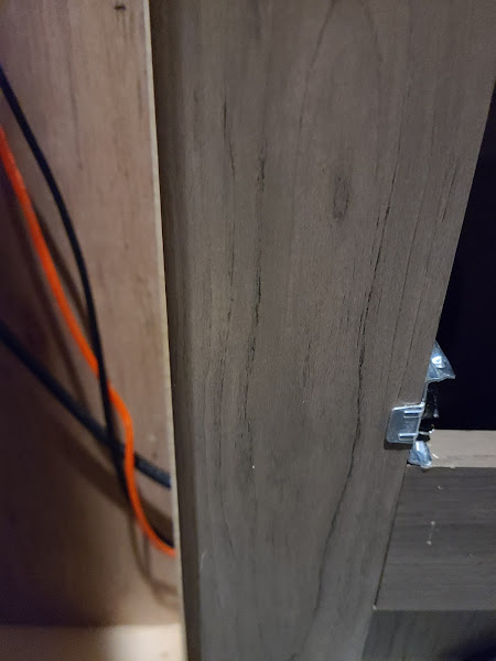

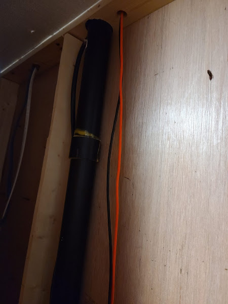

Inside the wall, there's a 1x4 header which seemed to be lined up with a rafter, so it wasn't as simple as drilling thru the header alone, but also thru the rafter. You might be able to see the solar cable coming thru the hole for the vent pipe... While I considered that, there just wasn't enough clearance for the plugs to fit.

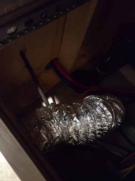

The bottom of the wall lines up with the power converter compartment, so I tapped a side exit, which then allowed easy access into the underbelly of the coach.

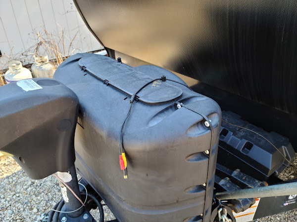

Once the wiring was in the belly, it was a very simple matter of using the fish tape again to pull the cable forward to where the enclosed belly ended and the A-Frame started. The last two feet along the frame are the only sections of exposed wire, and I used a few zip ties along the way to help keep it secured. Longer term, I may cover it with Eternabond to provide some UV protection.
