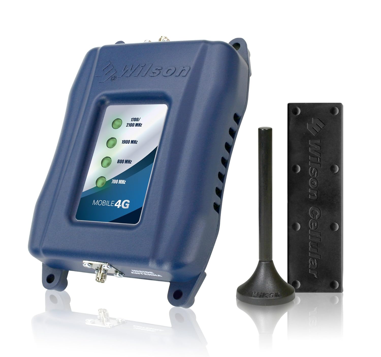

The following linked item will boost upto 4 devices at one time. They also sell cheaper single booster devices. The more expensive item does boost more signal strength. I recommend placing your mifi on or next to the internal antenna. I average 35db signal strength increase. The cheaper Sleek device I average 18db signal strength increase. With the booster I have cell and data service miles beyond other users.
I have Verizon. The CDMA tech works better in the mountains. The Verizon 4g is GSM. In July, I had Netflix where others had just enough signal to text.
Weboost (Wilson Electronics is the old name) does sell other antennas. However, every antenna has a downside. Different antennas can help 1x and 3g while hurting 4g. The included 4" rubber antenna is nearly indestructible and is mostly neutral.
Wilson Mobile Pro
