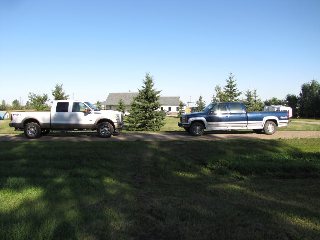

I have a 1993 GMC 3500 that is in extremely nice shape. It has a 4.11 rear diff and a 5 speed standard transmission. I am giving it to my daughter's boyfriend and we plan to replace the 6.5 diesel with another engine.
I have told him the easiest option would be to put a new Peninsular 6.5 diesel in it. If we replace the turbo and fuel injection system this will likely cost around 10k. The new engine would be a 2013 6.5 tuned to I believe 300 HP.
Option 2 is to purchase a wrecked 2005 Ram with the Cummins in it for $2500. The truck has 155,000 miles on it. I like this option but realize it may be quite a project. Anyone know what all is involved in doing this swap?
