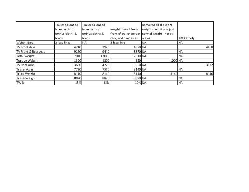

I have to come home early on Wednesday to go to the dentist (Broke a tooth while biting into a hamburger with a piece of bone in the meat). I plan on getting the truck and trailer in the current configuration over to the feed mill.
I plan on weighing the front axle, the loaded truck (still hooked up), the whole rig, just the trailer, and then I want to unload the weights in the front bedroom floor and get a weight of the trailer in traveling form without water. We’ll see if the scale house will play.
