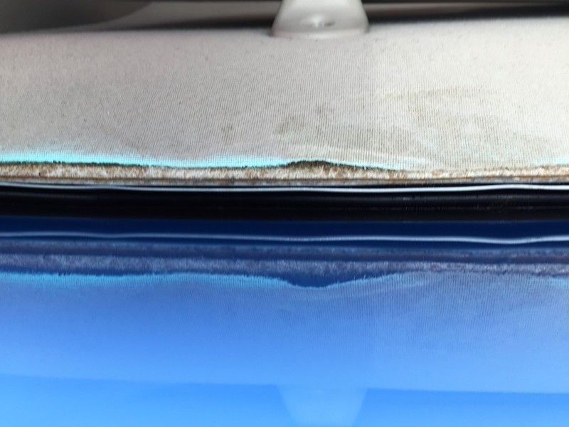

out rubbin' on the truck this morning...headliner options...
well... obviously I have failed to pay attention to detail... the
headliner cloth has separated all along the upper edge (windshield interface). Other then "ignore it" , where would I go to get repaired/replaced . Also, noticed my windshield is now "starred", chipped, and otherwise pitted as to be blinding when heading in to
the sun.., probably should get both done at the same time.
long term goal... get 20 years out of my truck. I try to take good care
of it.
any ideas, or experience with same viewpoints appreciated. :C I believe it is beyond stretching and re-gluing.
Charles

  • jmckelvy wrote:
    In my experience once it starts adding glue on those areas does not really help. Eventually it will sag elsewhere. I have done several vehicles the last being my 2000 Jeep Cherokee. It is not difficult but you do need to remove all traces of the old liner and adhesive.
    You can get headliner material at most fabric stores. IIRC I paid about $25 for the fabric for my Jeep. Use a real good headliner adhesive and take your time putting the liner on the backer or you will get wrinkles which are real difficult to remove as the adhesive is typically a contact cement.
    X2!
    Reglueing the existing material would be nothing more than a short term temporary at best fix.
    Headliner is a foam backed material which glued to a headliner board.
    Over time with heat and cooling cycles the foam deteriorates, gets crumbly and the cloth starts separating.
    Nothing can be done to make it stop once the foam starts going bad.
    Car stereo shops, custom speed shops or a auto upholsterer shop should be able to remove the headliner board from the vehicle, remove and replace the old material then reinstall the panel for you without removing the windshield.
    As far as the windshield faults, well not a lot can be done which will result in a permanent fix other than replacing. I have seen mentions about polishing but often that will be very labor intensive AND it may leave annoying distortions permanently in the glass.
    For polishing info you can do some internet searches for polishing telescope mirrors..
    Personally, I am not into that kind of abuse on my body, I would opt for a new windshield.. Check with Safelite, most windshields are around $250-$350 and THEY do all the work.
  • I did custom car audio in another lifetime. Taking an entire headliner out is very labor intensive. Most B-pillar removal starts all the way down at the kick panels.
    Most (good) stereo shops will know a good place to recommend, or might do it themselves. There's not many people better suited to remove then interior of car than those guys.
    This, assuming you're talking about a replacement not a glue repair.
    And yes it can be a difficult job. The new one will crease VERY easy if bent too much and be ruined.
  • In my experience once it starts adding glue on those areas does not really help. Eventually it will sag elsewhere. I have done several vehicles the last being my 2000 Jeep Cherokee. It is not difficult but you do need to remove all traces of the old liner and adhesive.

  • Find an upholstery shop and ask them if they can replace it. Not real difficult, just takes patience, the right tools and some money.
