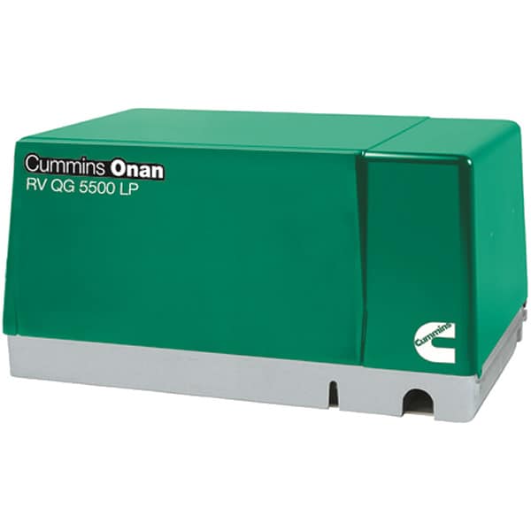

    You would want to pick up one of these RV STYLE generator packages..
    Then you would need to find a place to install it. Placing it on the trailer tongue or inside one of your precious storage compartments are about your only choices. Adding lots of weight to the trailer tongue has other problems to overcome... Also anything you mount outside is more prone to thief...
