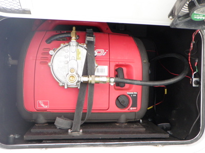

I bought a cargo rack from I think TSC which was plenty heavy duty, I think rated for 500 pounds. Then I bought a front receiver hitch from curt for $115.00 delivered to my front door. You will notice in the picture I had a welder weld metal plates into the base of the generator. Slid underneath, nothing is welded to the generator but the cargo rack and generator are one. Then I lock the cargo rack in with the highest quality locking pin I could find. I use this rig on the back of my 5th wheel setup and on the front of my truck camper setup. When not in the receiver hitch everything is accessible for working on the generator. I have been using this, this way for 9 years and many many thousands of miles with no problems. One thing I really like is the extra outside storage, from my old generator compartment and I can store more gear on the front rack. - bobndotExplorer IIIIt can be done. someone fit a Honda 2k into the Lance gen. compartment.
there is also a propane conversion avl .
