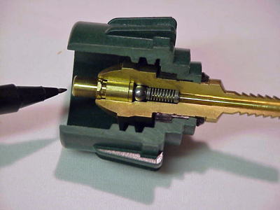

    Also quickly opening the OPD can trip the 'excess flow device' INSIDE the ACME Nut.
    Close OPD wait 30 seconds and then SLOWLY open OPD

    OPD---triangular handle, relief valve, liquid level 'bleeder' valve and connection (shutoff inside)
    ACME Nut 'stud' that opens OPD spring loaded shutoff vlave
    ACME Nut 'excess flow device' ---spring loaded ball bearing
    ACME Nut thermal bushing (First Edition)
    ACME Nut thermal bushing (Current Version)
    IF anything is stopping the flow of propane vapor it would be either the 'ACME Nut excess flow device' OR the OPD spring loaded shutoff valve
