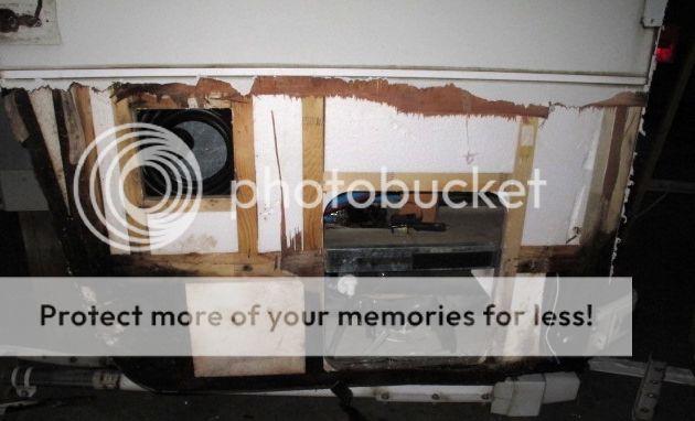

It is Friday, two days after I dropped it off...they have made good progress. Actually I am amazed at the rot damage but not surprised it was not more extensive on the overhang driver's side.
You may notice 3 holes in the lower white sytrofoam about 2"...we have no idea what they are for. Mike said it was probably when they put in the foam. I told him I put in the foam and I used 4 holes the size of my finger to install the expanding foam. BTW, it came out in one piece and was not wet and had filled the area in the nose.

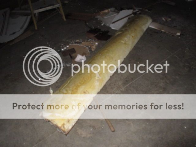

This is the front nose skin...note the metal portion that was at the tight radius of the nose. That was next to my expandable foam. It shows that some things we do are actually very good even so we cannot see the results.

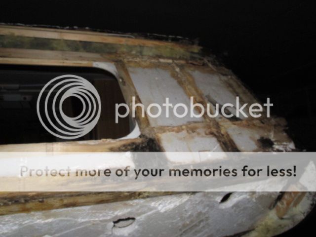

Front wall looks good except for the jack corner next to the slide. That window will be eliminated and repaced with a small security view port.
Wing is rotted. It is very wet and can squeeze the water out. Looks like water got in at the hole for the phone and cable as well as the moldings.

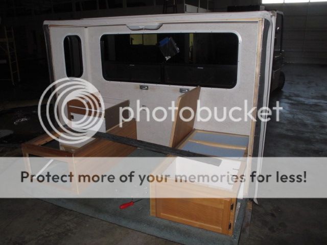

The slide is out.
