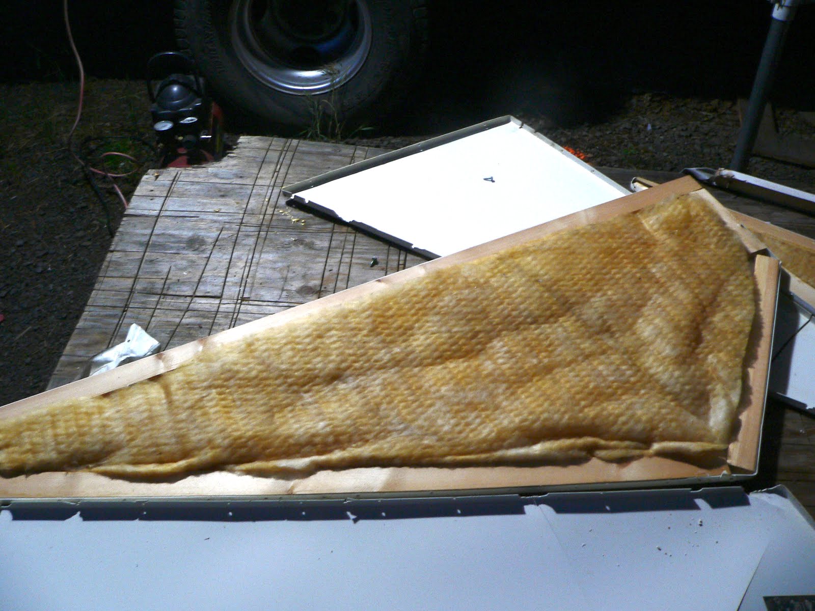

Most Amerigo owners pride themselves on that rear bed with its automatically opening and closing wings, however, in almost all cases, the thin thermoformed plastic shells are almost always disintegrating by the time any of us get ahold of them and while they can be glued and patched, that plastic is still brittle and forty years or more old. So, my plan was to completely remove them, and make a solid single hinged wing that would fold up against the “ceiling” of the Snap N Nap and be held in place by a sliding latch, one of the same ones that would later be used to latch the wall in the down position after the bed was opened so that it compressed tightly to the new sealing surfaces and make the snap-n-nap airtight and water tight to the elements, something the original design was lacking and tried to make up for with large amounts of vinyl.
Unfortunately, like everything else in Ms. Merry, the wooden anchor bar at the top of the snap and nap sides was installed with those damnable double inward crescent security screws. Since said screws just went through a piece of one by one cheap yellow pine, I just drilled holes in the wood near the screw heads through the piece and then wedged a flat head screw driver in the hole to split the wood and separate it from the screws, allowing me to pull the side down, so I could then use a 1/4” socket on my drill to disassemble the rest of the accordion for removal.

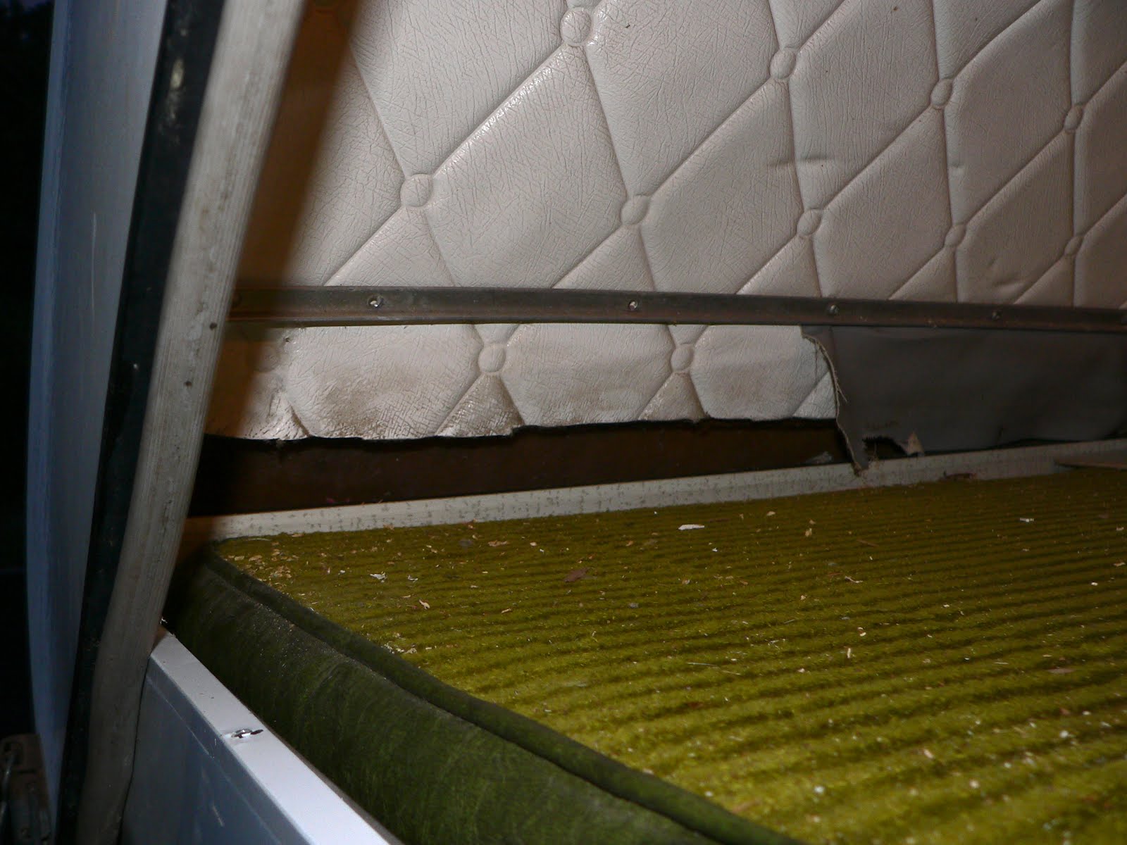

What I wasn’t anticipating to find was that the only thing attaching the bed pan to the outer clam shell of the snap-n-nap was these flimsy plastic accordion sides that have no structural frames at all inside them. I expected there to be a second piano hinge along the top far edge of bed pan that attached it where it met the clamshell so that the bed was hanging from the rear wall and the clamshell at two points with the sides just being attached so that they would automatically open and close.
Investigating behind the rotten vinyl I can even feel what appears to be a 1x4 piece of wood embedded into the fiberglass of the clam shell at the height where that piano hinge should be. I don’t know, as these pictures are the first I’ve ever seen of the inside of an Amerigo’s Snap-N-Nap accordion sides, if this was by design, which makes little sense, given the wood you see in the pictures isn’t even attached to one another, they simply line the edges and are held inside the clam shell by a couple staples through the plastic. There is absolutely no way these were mean to the load of that bed and its occupant, there’s simply not enough structural integrity to them to do that.
I might have believe it possibly the case, had these been welded aluminum frames or the wood was actually attached to one another, but there is literally nothing structural to these, and I seriously cannot believe a company would think a thin strip of Vinyl would be enough for a load baring hinge.
My only conclusions I can draw are, there was a hinge that was supposed to have been installed, it never was. Some previous owner removed it and never reinstalled it, but there’s no evidence of one ever having been installed.
Directly behind that vinyl below that screw strip is that "potential" 1x4 piece of embedded wood. The bed pan is currently hanging low on this corner because the side has been removed. I’ll be setting up a cradle tomorrow to support the bed pan so I can fully detach the clam shell from it and set about installing the missing hinge.
From what I’ve peaked behind the vinyl I’ve pulled free, its a very real possibility I may need to glue a 1x2 frame onto the fiberglass to give me a surface to anchor the RV wall paneling to to install it.
