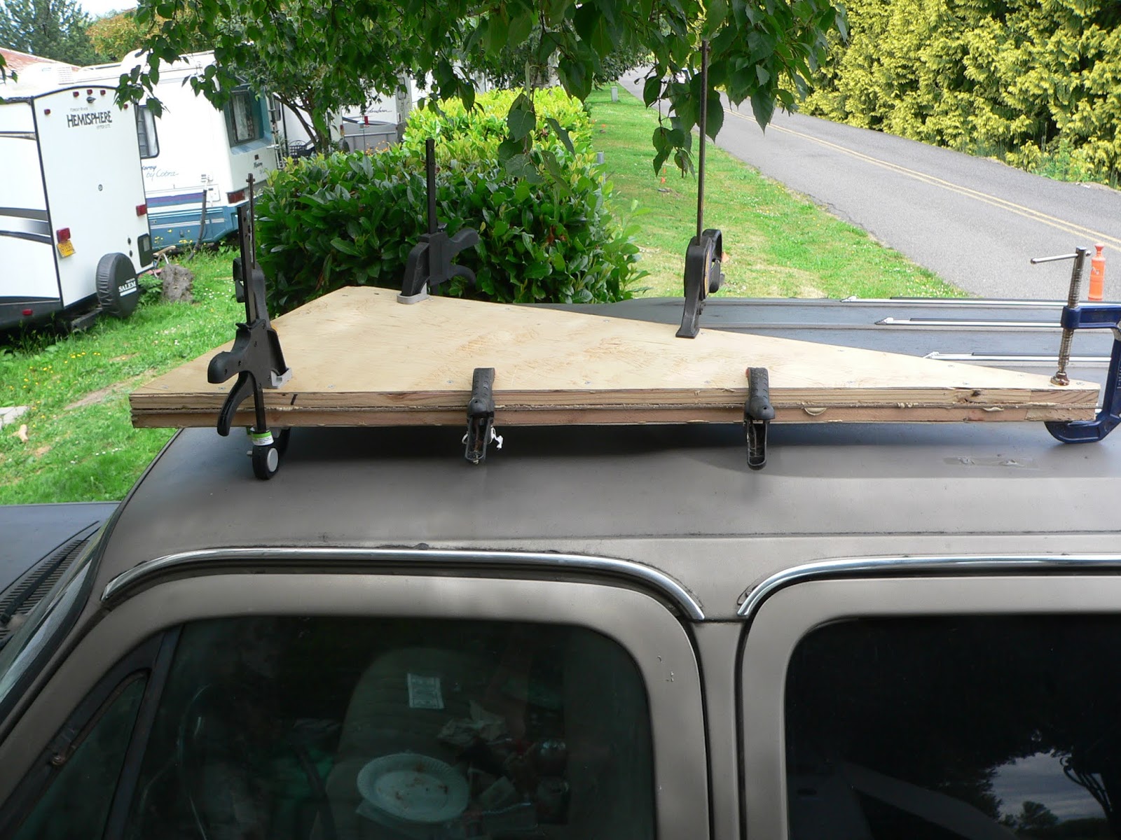

Since we can't really hide the staples we use for anchoring the wall board in place while the adhesive cures for the inside, the solution has been to apply the adhesive to all the gluing surfaces, then temporarily clamp the panel on the mirror side of the section we're working on so that we can flip the inner wall sides facing each other and make a compression clamp sandwich of the two, using the wing pieces to give us a nice tight bond.
These will be left to cure for about 24 hours in this state so that the glue properly sets up before removing the clamp sandwich.
Because I'm working on a few different areas of Ms. Merry at the same time, the second sandwich got set up on the roof of Beasley the Bambi-Slayer's roof while the work bench got used for other tasks :p

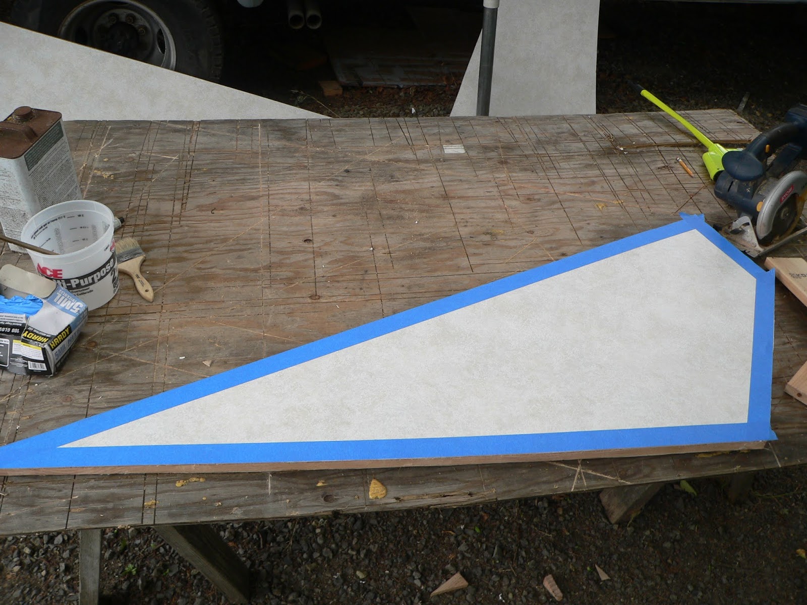

Now, that the panels have had a couple days to finish curing, we can tape up the corners of the RV wall panel side so that over run from the base coat of fiberglass resin won't get on the nice wall paper sides of the wings.
We'll be removing the tape after the first coat has had enough time to setup to were it can be touched, but still soft enough that we can remove the excess by simply peeling the tape of.

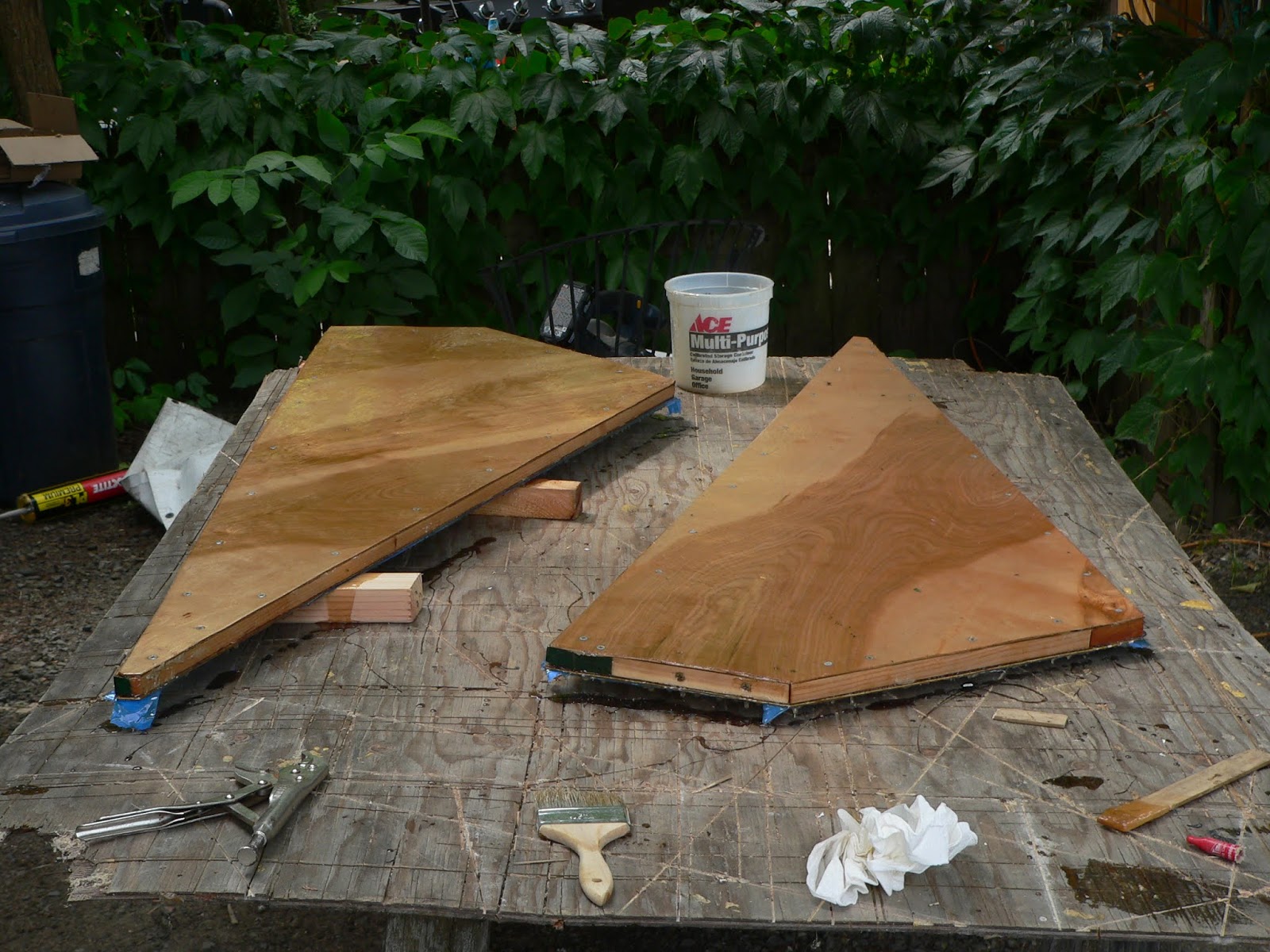

We'll be applying multiple layers of fiberglass resin, along with the cloth after this base coat, as the base coat is simply meant to seal the pores of the wood.

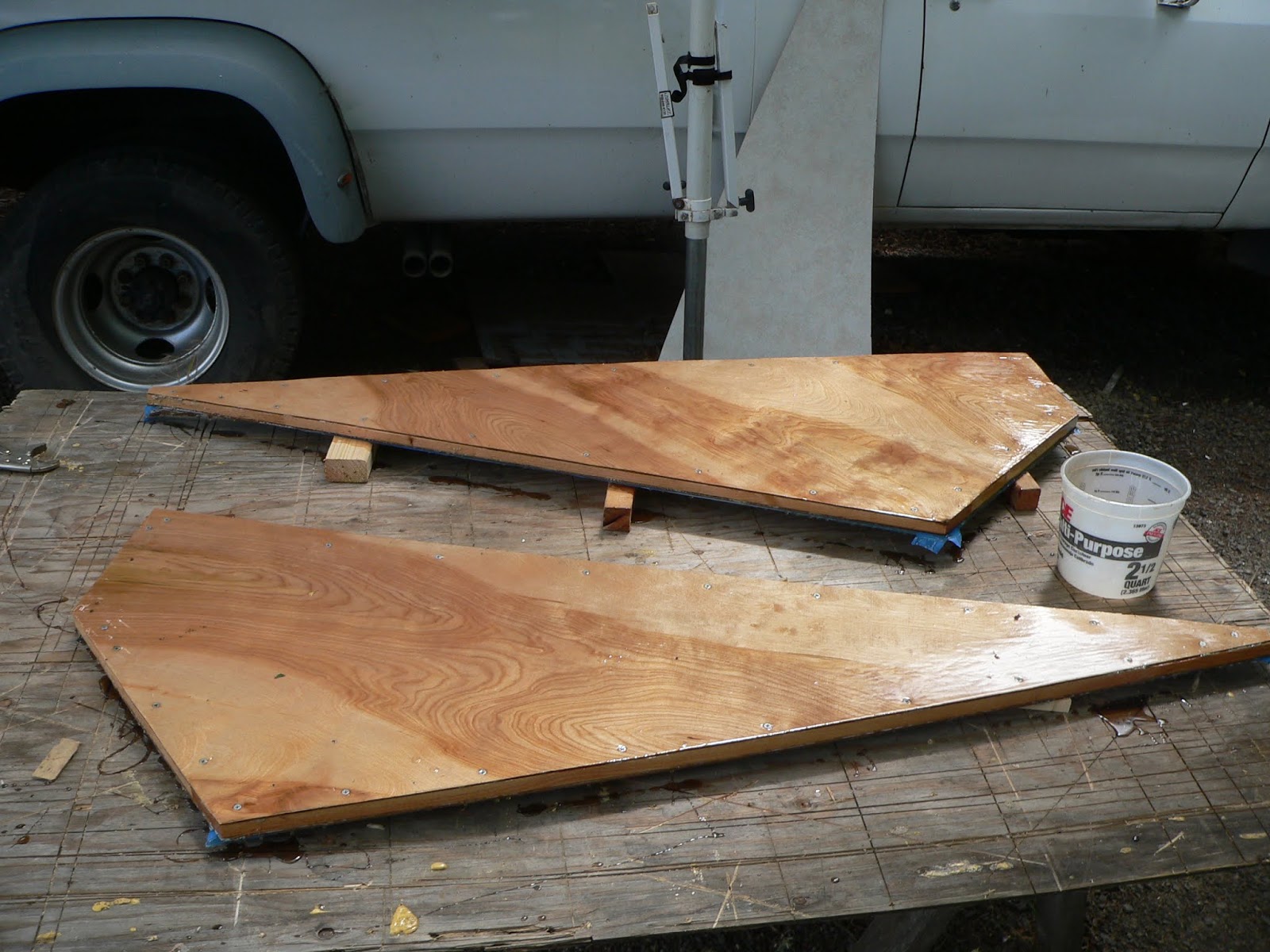

The results of the first fiberglass coat, looking shiny! We'll fix that with some nice sanding to prep it for the application of coat number two, and the fiberglass cloth around the edges.

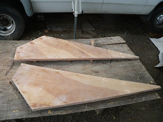

And sanding is complete!
