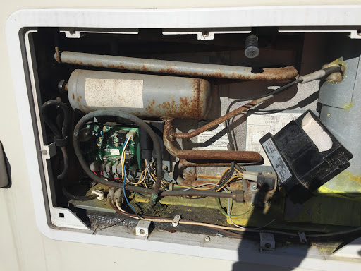

Previous Owner of our camper, 2000 Coachmen Futura 2790TB, indicated that the circuit board for the fridge would need to be replaced. I'm looking into this and noticed a loose wire from the board, blue wire in picture. Any idea where this is supposed to go?

  • Not sure about the blue wire but the yellow stain indicates a cooling unit failure as newman fulltimer suggested. I wouldn't waste any money on a new circuit board.
    I've seen where some folks have decided to change out the old fridge with an all electric fridge that's close enough to the same size, and do a little trim work to make it fit. It's a lot cheaper than a gas/electric.
  • it goes nowhere its a factory wire but seeing all that yellow your fridge cooling unit is toasted
