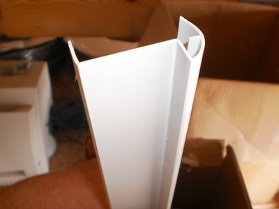

    Plastic RV door jamb is relatively inexpensive and easy to get - comes in different wall thicknesses. Interior RV doors usually use a simple surface mount hinge like in the photo. You can buy RV bedroom/bathroom door locksets like at rvlocksandmore.com for ex. but ordinary residential ones will work.
