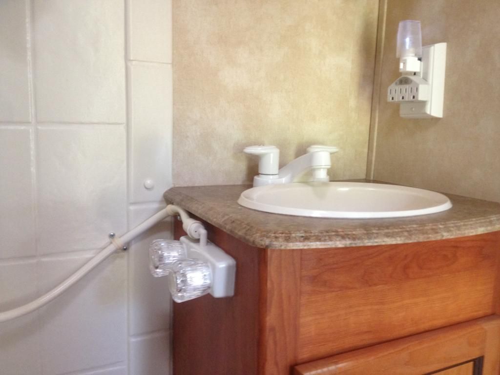

Inspired by AnEv942's bath makeover and a balky sink diverter valve we decided to redo our shower even though it is a new camper.
Poor/cheap design forced one to reach over the wood sink base while dripping water to adjust the water temp while showering.
This shower valve has no balky/clunky diverter and can be adjusted through the shower curtain with no wetting of the sink base.
The sink faucet was switched out also as there was no need for the diverter valve on the original.
Both faucets together came to less than the $35 threshold at Amazon for free shipping so we padded the order with a bag of hose/pex clamps.
The sink cabinet was barely useful for a can of corn so while the false wall was out for replumbing it was given a makeover.
We now had room for laundry supplies , GEO system tank treatment supplies , and a full size medical kit in the fishing tackle box on sale at Rural King farm store for $7.00

  • Due to the small sink cabinet the new faucets had to have 90 degree hookups and I could only find that in PEX.
    The outside shower was connected as shown at the factory.

  • Hey nice faucet :)
    Oh you have a 'dry' bath- Now I see what you were referring to when considering surface mounting the shower valve. Looks good. That works, placement of original diverter valve was a bit odd. Gotta wonder sometimes when folks design stuff.
