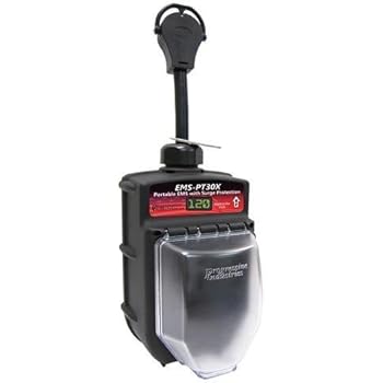

I bought a surge protector for my camper. My question is if it is safe to have a uncovered connection because with the surge protector the length makes the connection outside the box. Thanks

  • I just purchased a EMS-PT30X 30A Digital Surge Protector with Weather Shield from Amazon. Was cheaper than the previous model.

    These portable surge protectors are designed to work outdoors but if you're so concerned about it just locate it at the trailer, tuck it under a slide or under the body of the trailer, and run an extension out to the power post. Another solution - install your portable unit inside the trailer, just as you would a hard wire model and just as I did with a TRC unit I used to own.

  • Old-Biscuit wrote:
    I have a portable 50V Progressive Industries surge protector that for past 10 yrs + has hung from a power pedestal receptacle in most every weather condition.....heavy rains, snow, sleet/ice, hail, hot humid temps, hot dry temps etc.
    Never had an issue.
    They are made to be used outside----hard to do otherwise.
    Our 30 amp PT portable (old style) has only had 2 trips so far, but the last one was a week long and it rained every day, with a couple of major gullywashers, and no problems. The rain didn't seem to have any adverse effect on it.

  • I had been using the same PI EMS-PT50C for almost 7 years until September 2016 when a lightning strike in the park I was in apparently sent a surge to me and one leg of the PT50C died (no damage to my rig or any electronics). It was the original design with the open socket and never an issue. It was sent to PI for warranty and they replaced it with the new design with the lexan cover that flips down over the socket. I also had a spare PT50C also with the open socket which was put in service in September 2016 when the above lightning strike occurred and this past March I was in a major thunderstorm with 50-60 mph winds and horizontal rain. The PT50C would not work after this storm passed. My spare was put in service while the dead unit was sent back for warranty. It too was replaced with the new lexan covered design. This was the first issue I had with the open socket design in almost 7 years full time service, but then this was a major thunderstorm.
