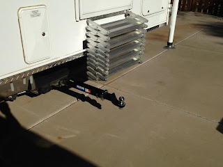

Mello Mike wrote:Wayne, I've been hearing about your hitch for years now. This is the first time I have seen it. I like it. :)Reddog1 wrote:Thanks, Wayne. I understand now what you're saying about the tubing for the side forces. Looks pretty sturdy. :)
This is an old (2004) photo. The extension uses 2"x2" 3/16" wall tubing in instead of chains, for the side forces. Way overbuilt, and adds unnecessary weight to the truck. I have chains to replace the tubing, but keep using it for other projects. I have the tubing on the truck now, but again I will replace the tubing with chain.
kerry4951 wrote:I agree with that.Mello Mike wrote:Mike
I can see the need for stabilizing chains for long hitch extensions greater than 40" but why would you need them for something much shorter? My extension is 18" long and I've run into zero problems without them.
With your size extension I would not worry about using stabilizing chains. My guess would be to consider using chains on anything longer than 3 feet or thereabouts.
WarrenS wrote:The chains are actually most effective connected where they are in the pic, at an approximately 45 degree angle between the receiver hitch cross tube and the extension bar.kerry4951 wrote:I think I would attatch the chains to the safety chain loops near the end of the hitch rather than the loops.

Thats the purpose of the loops, to attach the safety chains. Keeping the chains back on the loops keeps them out of the way and still makes the whole rig rock solid. Maybe some do hook off their chains at the end of the extension, but I never saw a need to do it.

I have a Superhitch and a short Torklift extension. I would recommend the Torklift parts if money is not a concern. The system works very well and I don't have to worry about the hitch failing and injuring someone. I tow about 7,000 lbs.
