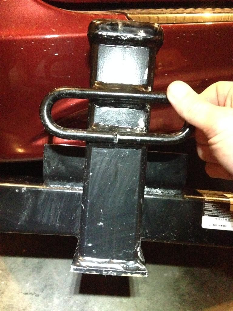

Initial observations are this this thing is beefy... the hitch it's self is physically larger and stronger looking than my 1997 F150's Receiver hitch. Here are some pic's of the hitch

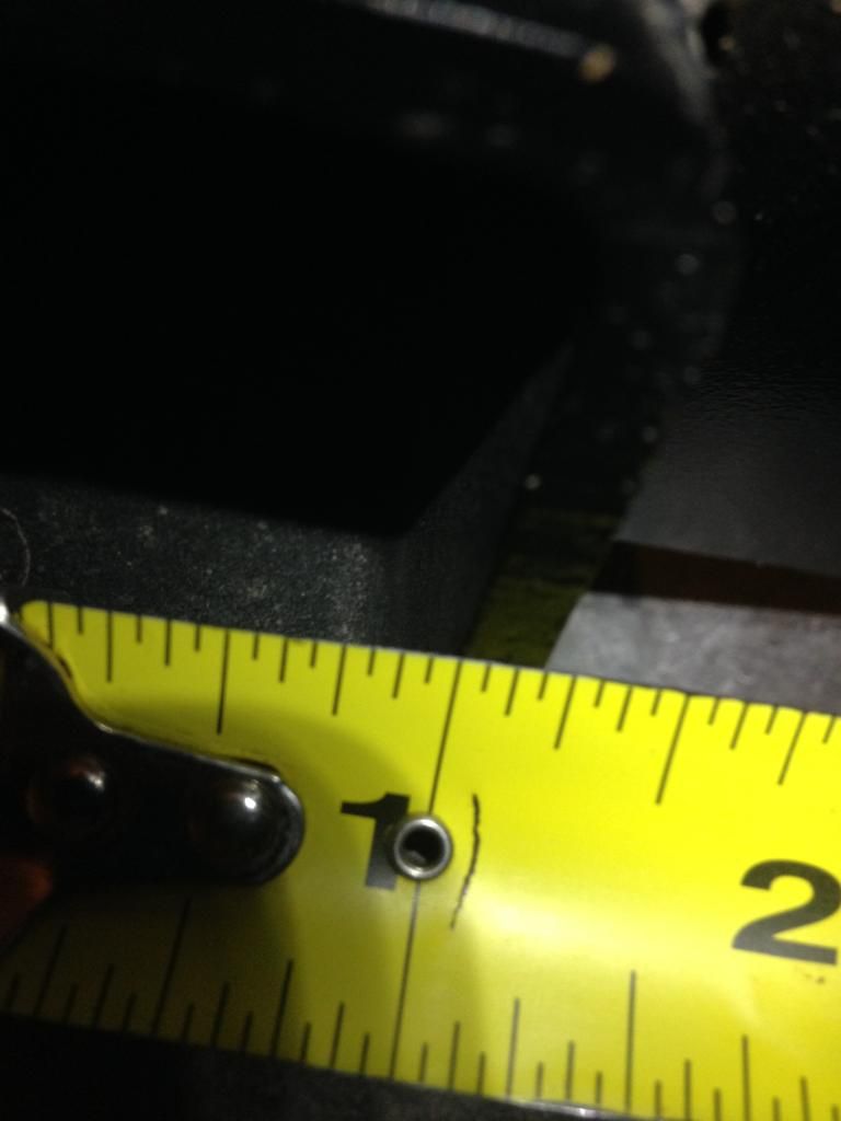

This measurement was consistent over the entire hitch, I measured starting at the 1 inch mark for consistent measurements.
Top of the receiver tube

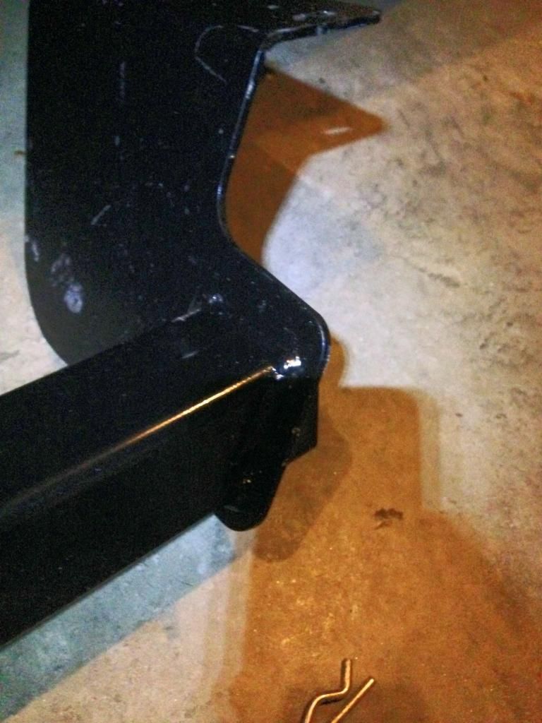

Here is a shot of the welds..

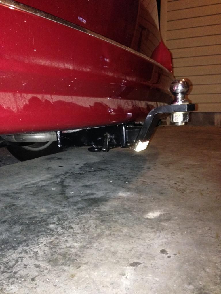

Here it is all installed and everything buttoned up. It all hides really nicely under the rear bumper cover. Jack stands are your friend when you install one of these things yourself btw...

    Good photos. I installed a class III Curt hitch on our 2013 Grand Caravan. It also tucks in nicely behind the bumper cover. My Draw-Tite on my 2004 Ford Freestar tucks in the same way. It always bugs me to see the Toyota Sienna vans with the hitches hanging down really low.
    I agree with the comment about keeping the lights inside. I have not installed mine yet (I have all the parts). I installed the hitch myself last year, but health issues prevented me from doing the rest of the work, but installing the wiring inside is easier than crawling under the van. Good idea.
