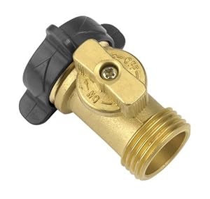

I took the crummy little check valve out and put on a fitting with a shut-off valve. Problem solved.

You can install a garden hose shutoff valve on city water connection
I installed a 90* elbow first and then a shutoff valve on both city water connection and black tank flush connection 7 yrs. ago.
I just leave 90* elbow and valve on all the time
