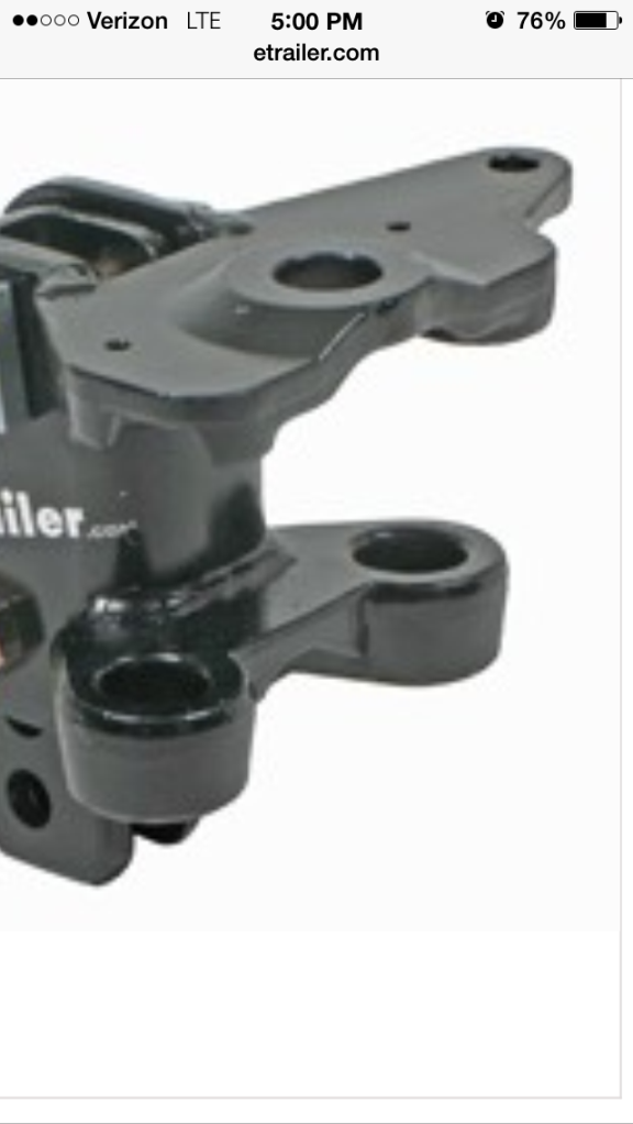

  • I will steer you away from this hitch for one particular reason.
    The lower trunnion socked is incredibly thin.
    Here is a zoomed in picture of the hitch head you are looking at. Pay attention to the thickness of the lower trunnion socket.
    Now look at a modern trunnion hitch heads lower trunnion socket.
    This is important because the lower trunnion carries an incredible amount of pressure and if the lower sockets are worn the trunnions could literally pull out of the hitch head. Sounds crazy, but it happened to me.
    Thanks!
    Jeremiah
