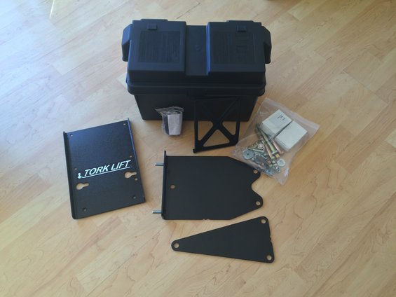

Where to install an extra Battery?
I've always been very please with the Products from TorkLft,
& I've been struggling with the thought of where can I add a 2nd battery into the very limited area on my truck with a Lance 900 camper on it?
Normally I try to get electrical hook ups when I vista your typical camp ground & yes U do have a 2.8 Geni.
But even then most camp grounds have limited hours they allow you to run the Geni.
& I have many more trips planned to places like Pismo Beach & other places like the desert & the moutons & etc etc....with no hook up at all & figure I need the extra 12 volt power.
I really DO NOT wanna give up compartment space to fit another battery but have been considering it for the past year..
But then kooky here & What TorkLift is offering.
http://www.torklift.com/index.php/products/auxiliary-battery-storage/hiddenpower?highlight=YTozOntpOjA7czo2OiJoaWRkZW4iO2k6MTtzOjU6InBvd2VyIjtpOjI7czoxMjoiaGlkZGVuIHBvd2VyIjt9
So I now have the products & have to save up to buy the biggest Battery that will fit in the box.
& then get started on this project.
Here the parts I got from TorkLift.
Whats awesome about it is that it bolts inside the frame rails under the truck & saving me what limited space I have above..
hound be a great set up for my needs.
the question running through my head is is do I run them together or install a switch to have it as a back up battery incase the other one fails?
Either way should work?
Yet if I keep them apart I will always know what battery is the bad one & that alone could be helpful?
