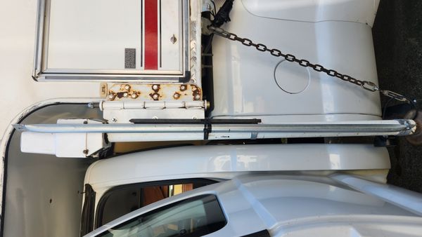

Front braces stowed in travel position. secured with two 100# rated zipties.

  • what in the back woods do you have going on with the rear jacks?

      Speaking of…what is going on with the front of the truck bed and the something that kinda resembles a cut up rear bumper for the wrong truck in the wrong location?
      Now that I think about it it’s a F550 that I don’t believe was ever offered as a pickup (unlike the 450 models which were a little different than the c&c trucks but I didn’t think that started either until the first refresh of the Superdutys).
      If this truck has a pickup bed cobbled onto a straight frame, may want to make sure that’s legit for hauling 2 tons of high profile load. Or the tiedown chain rodeo that’s going on will not be your greatest concern.
      And assuming the bottom of the front of the truck bed is solidly attached, block the camper off the front of the bed at the bottom with some lumber or sumtin so’s you camper won’t be smashing into the top of the bed and trying to make out with the back of the cab.

      Ya, yikes!
      If them 45deg angle front chains ain’t doing the trick or bending the tie down brackets on the truck, find less “extreme” trails or quit using crisco on the bed mat.
      PS they will do nothing for side to side sliding but a couple well placed boards between the inner fender wells and camper will stop any excessive lateral movement.

        I have side blocking in the rear of my lift platform for cab clearance.  The front tiedowns are positioned at 15 to 20 degrees, not 45. The TC is somewhat reinforced in the tiedown area. I could create a mount plate farther back to get about 45⁰ on the chains. I'm going to set the rear chains to start engaging when the TC has slid back about an inch so they will have less force exerted on the jacks. I'll use them as a limiter. I may install front side to side blocking when we get back from this trip.
        Side note, it's not crisco, Lucas Oil Gear Lube. Keeping up with technology. Also acts as wood preservative.

      That is an experiment to work with the front tiedowns to minimize the backsliding and side shifting of the TC going up steep rough hills. The framing and attachments have been reinforced so they should be able to handle any strain.
      I'll keep you posted as to how it performs over the next week or two.
