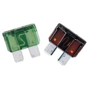

    You can also very easily plug in a standard ATC type automotive type fuse in this connection plug. I would use a 15AMP fuse I guess... Each of those automotive incandescent bulbs will probably draw at least 1AMP each.

  • You jump pins #3 and #4 on the harness. Some just use a 12 gauge wire some a fuse. I think they also sell an adapter to do it as well.
