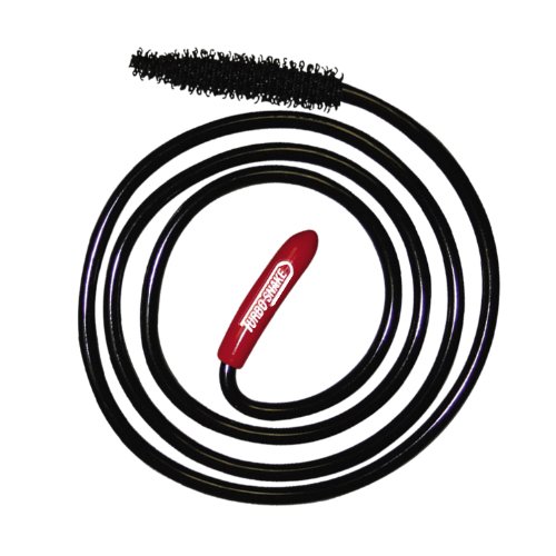

Those little zip-it snakes work great and are cheap - would try that first before resorting to Drano. You might be able to get some idea where the clog is by watching the water go into the drain. If it slows down or stops quickly, the clog is probably in the P-trap. If it takes longer, the clog could be downstream somewhere. Hair buildup behind a drain cover is common and can sometimes be before reaching the P-trap.
