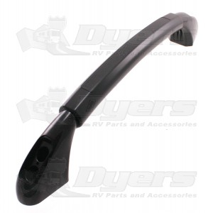

    When we ordered our latest TT, a 2014, we specifically requested that the factory NOT install any exterior grab handles (we have 2 ext. doors). We got the dealer to install two black Stromberg Carlson "soft touch" grab handles (left photo). The Strongberg Carlson ones have a really nice soft feel when you grab the handle and you won't lose grip. They are fantastic!! There is at least one other one that looks identical, made by RV Designer (right photo). The grab part of the handle is too hard IMHO, and not soft and comfortable as the SC one.
    When we installed the same handle on our first TT (with aluminum siding), I took the old stock handle off and just used RV caulk to seal the holes. No one will notice the caulk except you and it's hard to see unless you are inches away. I also re-installed the original handle on the interior side of the door as an extra assist device (DW was suffering severe vertigo at the time). Installing one can be a bit tricky depending on how wide the stud is beside your door opening. You may have to notch the handle slightly where it attaches to the siding so that it slightly overlaps the door trim to allow the mounting screws to adequately sink into the wood or aluminum stud. You may also be able to install the screws at a small angle. A little clear RV caulk along the top and sides of the handle where it attaches to the siding will help keep water out.
    This is one upgrade I highly recommend and I guarantee you'll like it (no refunds tho.)
