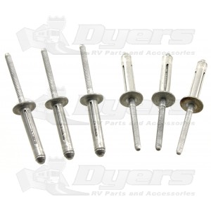

  • Oscar rivets work well in luan plywood and are strong. Available online at some RV parts vendors like here.
